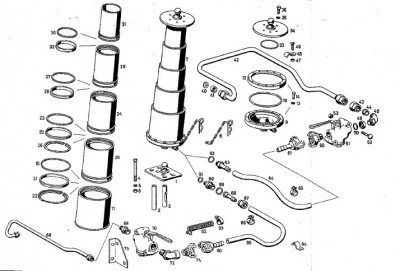

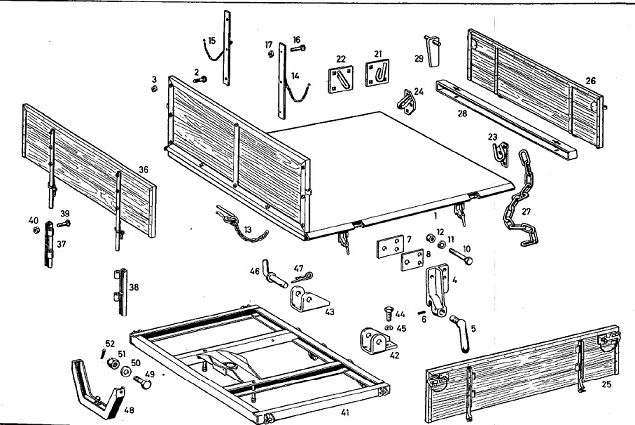

Only for clarification:
two way tipper comes only with pneumatics.
threeway tipper comes always with hydraulics.
the Meiler system (mix between both systems above) is not available.

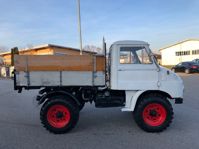

Thank you everyone for your replies
1) Does anyone have a photo of the NENCKI, Schmitt, Meile pump or hydraulic cylinder mounting arrangement? I suspect the NENCKI pump may interfere with my winch drives and the NENCKI valve and tank arrangement is very cool but this is where the folding top stores.
2) . Some reading indicates that there was an engine driven combination hydraulic pump and compressor?
3) . Any suggestions for finding parts would be most welcome

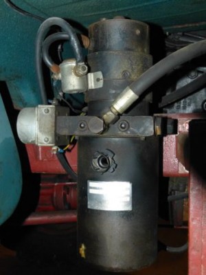

#529912
Also electric driven hydraulic power units were used in early Unimog, e. g. a FENNER STONE unit left side back under the cabin.

Christoph . Thank you for the reply - that electric unit is very interesting - that system definitely reduces the complexity.

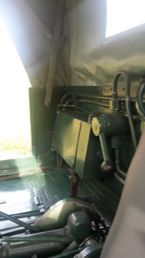

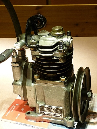

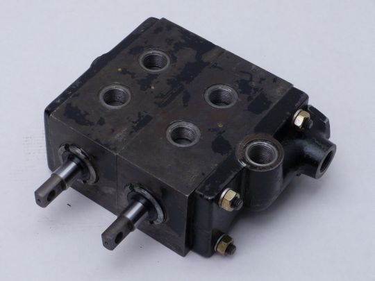

Hello Ike,
attached you will find a "Kombipresser" consisting of a hydraulic gear pump and a piston compressor. In best condition this would cost much more than 2000 €. A good valve block is about 600 €. A recently built cylinder is available from some suppliers around 700 €.
Concerning the NENCKI circuit I also never have seen documents about. But I will have the chance to see in nature and take fotos of next weekend. You will see.
#529965

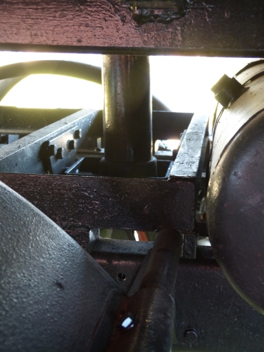

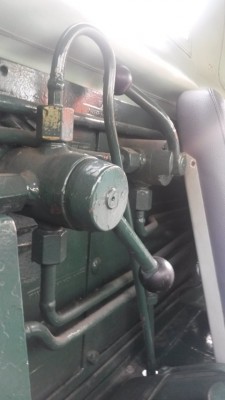

Ike,

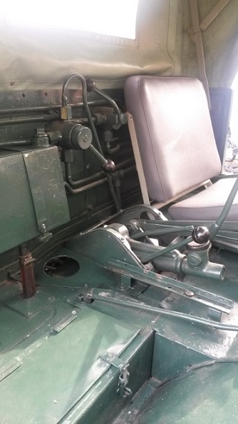

unfortunately there was not enough time to take all relevant fotos and to definitely understand the hydraulic circuits. Neither I didn't succeed in tipping and I didn't check if back tipping is possible (probably yes).
The Unimog Markus had shown, is the one I investigated on. The tipper platform as well as the hydraulics are from NENCKI Langenthal/Switzerland. This Unimog in addition has a front hydraulic circuit which consists of a Toggle Valve and a Valve Block with two double acting sections which was used in the early Unimog 406 (U65) too. To me it is not clear if this front hydraulic circuit was also installed by NENCKI (probably not).
However, the NENCKI solution is quite interesting. The tailboards can be supported in horizontal position by a lever when unfolded.

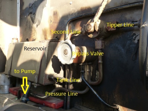

#529966
... The axial piston pump is attached to the right hand side of the main gearbox where normally the pulley sits. It is activated by switching on the PTO.
The back hydraulic circuit is pressurized by a hand lever valve alternatively to two lines: Tipper Line and Second Line.
A Bypass Valve can be used to lower the tipper or to unload the Second Line. This is similar to the floating position of the WESTINGHOUSE valve blocks.
A Toggle Valve switches between back- and front hydraulic circuit.
#529967
... The tipper cylinder probably is a plunger type (single acting) in opposite to a telescopic one from HUNGER or WEBER in the German Unimog.
Conclusion: The NENCKI system is favourable, but quite hard to re-build (PTO on the right hand side).
