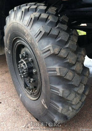

I am thinking about an experiment to install Russian off-road tires 12.00 R20 (Kama 402, Omskshina M-93...) on my Unimog U900 (417.101).
Reasons: (1) those tires are available in Serbia at a reasonable price and (2) bigger overall diameter (1142 +/-8 mm) than the original 12.50 R20.

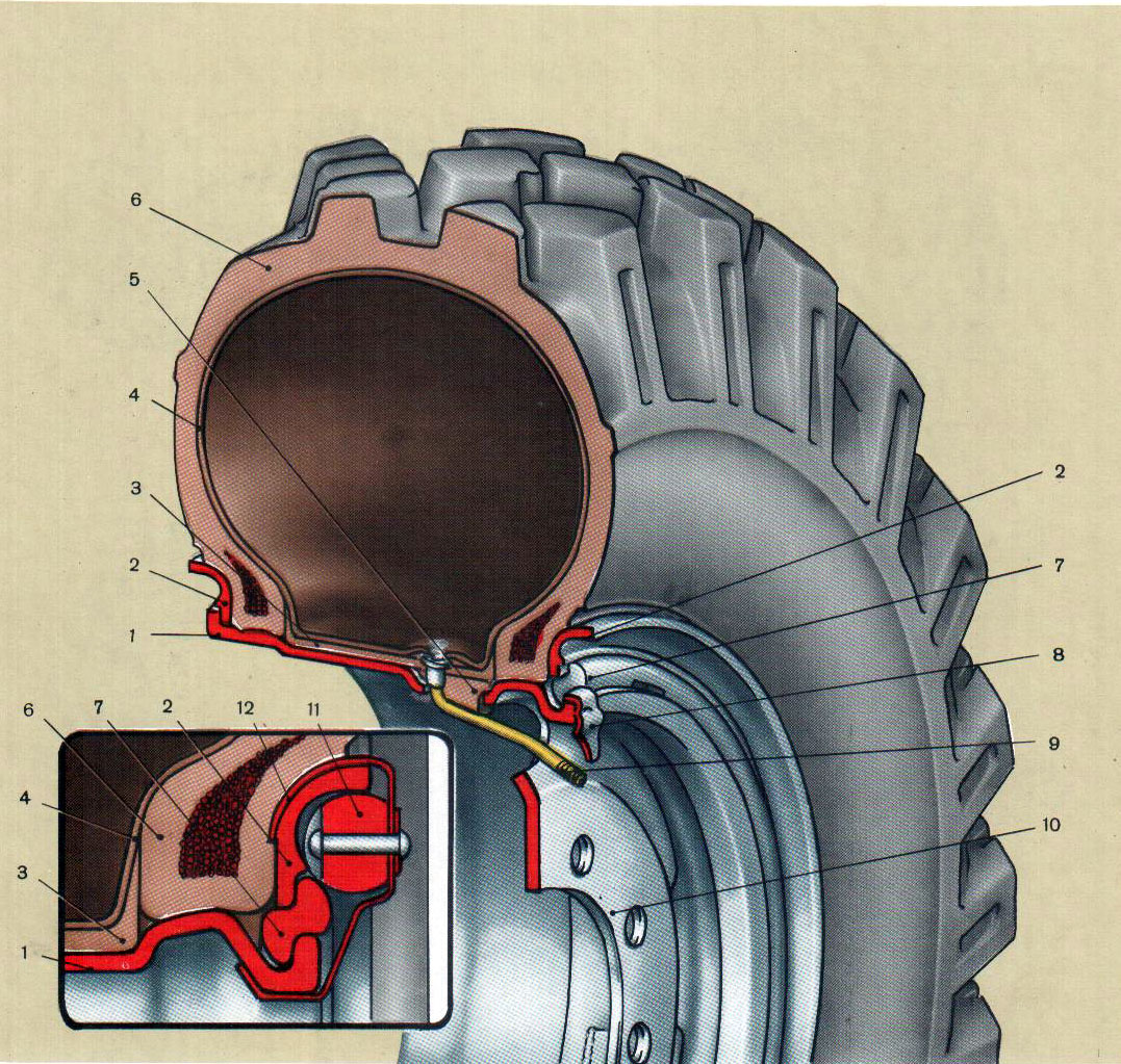

I worrying now what Gerog said in the post above :? – the Russian’s type off-road tires require the “three pieces rims”, as it is originally used on ex-Soviet military trucks!?
#559777
eu1700 hat geschrieben: 20.01.2022, 13:10 hallo Vucko,
the Rims do not fit to this Tires, you need Rims in 3 Peaces ftom Truck.
Gruß Georg
Thanks Georg. I di not think about that aspect :?
You are talking about old rims type with two rings like on the picture attached...
I have to check if those tires can be mounted on standard modern Unimog rims.

#559790
Hello Vucko
for using truck tires, you need rims 10V20. This rim type was mounted at my 417, when I bought it.
Type 10V20 shoulder is higher than sdc type 11-20 for mpt types.
Part number ist 427 401 01 01, offset is 82mm.
