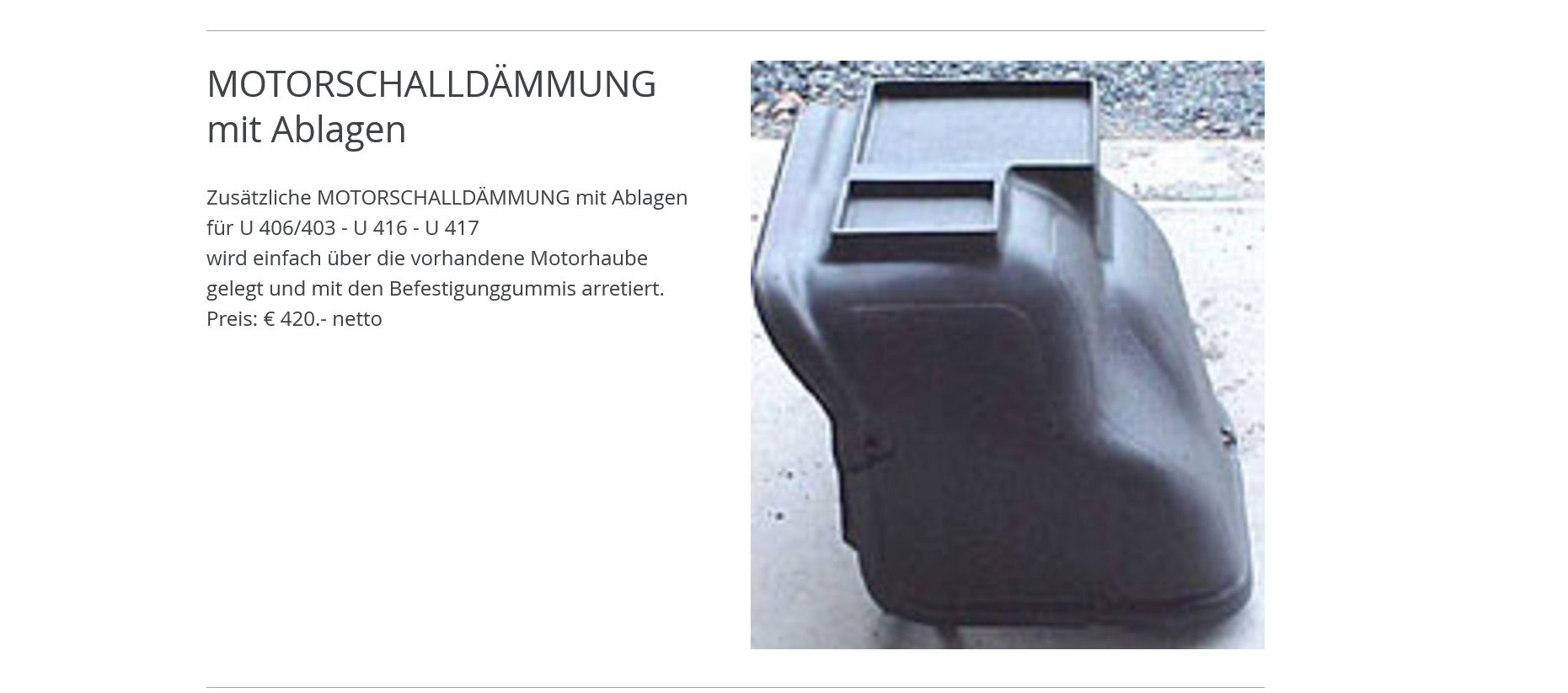

Hello Nicola
there is a well insulated bonnet like the one used in the 417. However, it is very rare to find and of course very heavy.
The company Holster offers an accessory cover that can be put on, which has a similar effect and also has a practical storage area.
Here is the link to the company's offer Fa Holster
l
Screenshot 2025-03-11 at 09-46-03 U406_4003-416-417 H.P. Holster Unimog.png (537.43 KiB) 3425 mal betrachtet
The space available in the engine compartment offers little scope for installing additional sound insulation.
However, the sound reflection in the cab can be reduced with additional panelling,
The exhaust manifold on the engine and the exhaust pipe should be well insulated against heat and noise
