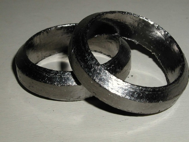

Which seal on "down pipe" you mean (photo or article no.)

The exhaust seal you can get for example from VK SARS BVBA (Belgium)
https://www.google.de/url?sa=t&source=w ... 4coHrZYVyv
