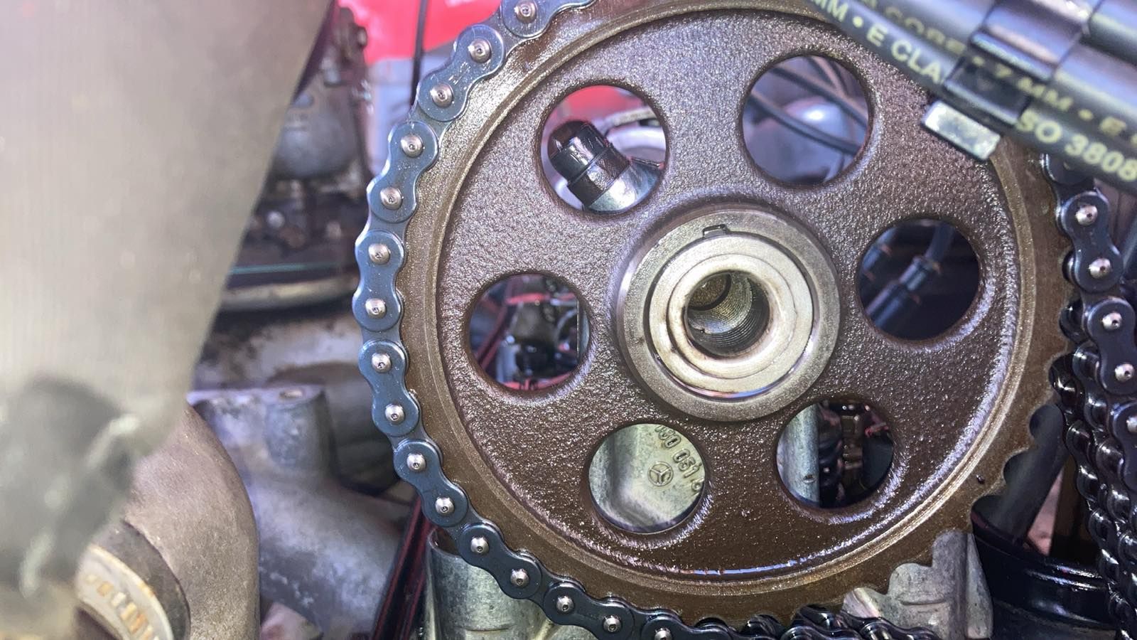

I was able to rotate the engine till TDC 1-st cylinder (6 Gang and some effort :sweat_smile: ). The mark of camshaft seems to be almost there, but the problem is, that the mark is behind 'the spoke' of timing gear, instead of opening ...like into Jurgen picture. So I can see the mark just with the phone switch to front camera...technology..ha-ha-ha. I wonder is this normal???

Hey Andrey,
i think this is not normal.
The timing gear is normally fixed in postion by a small feather on the camshaft. By this the timing gear can only mounted in one fixed position and I don't think that the delevoper designedthe marking behind a spoke

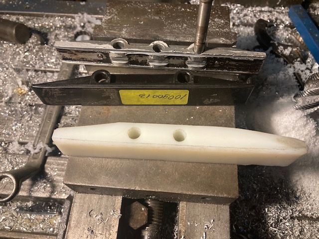

I unscrew the bolt of camshaft and seems to be ok...the key is there...I really don't want to remove the sprocket.
0-02-05-1cfe9068b4389ac51425b73bc263f76fd2dccb5abd9bc8b9bec44af8b4932090_8c1b4fa861df592b.jpg
0-02-05-1cfe9068b4389ac51425b73bc263f76fd2dccb5abd9bc8b9bec44af8b4932090_8c1b4fa861df592b.jpg (264.18 KiB) 5388 mal betrachtet
The broken timing chain guide...It\s really rare and at least 200 Euro with long delivery, so I made one from Polyamid
